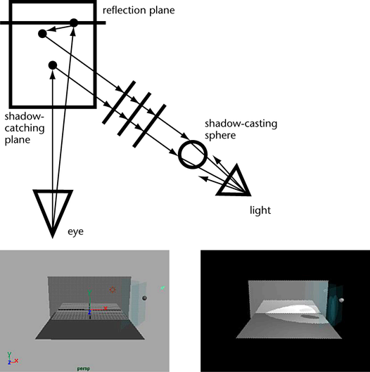

- Use Ray Trace Shadows
If on, the light produces raytraced shadows when the scene is raytraced (that is, when Raytracing is on in the Render Settings window). Use Ray Trace Shadows if off by default.
- Shadow Radius, Light Radius, Light Angle
Controls the softness of shadow edges by setting the size (Shadow Radius or Light Radius) or angle (Light Angle) of the light. For example, a large light produces softer shadows than a small light. The light radius is also used for light glows to determine the occlusion/visibility (for point and spot lights).
The Shadow Radius attribute is only available for ambient lights.
The Light Radius attribute is only available for point lights, volume lights and spot lights. The slider range is 0 (hard shadows) to 1 (soft shadows). The default value is 0.
The Light Angle attribute is only available for directional lights and volume lights. The slider range is 0 (hard shadows) to 180 (soft shadows). The default value is 0.
- Shadow Rays
Controls the graininess of soft shadow edges. Increasing the number of Shadow Rays also increases rendering times, so set it to the lowest value that produces acceptable results. The slider range is 1 to 40. The default setting is 1.
- Ray Depth Limit
Ray depth specifies the maximum number of times a light ray can be reflected and, or refracted and still cause an object to cast a shadow. Transparent objects between those points in which the ray changes direction will have no affect on the light ray's termination. This can best be visualized by example in which the ray traced shadow is visible on both the ground plane and reflection plane. If the ray depth is set to 1, the shadow will only be visible on the ground plane. If the ray depth is set to 2, the shadow will be visible on both the ground plane and the reflected plane.
