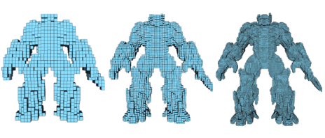

This example shows a character mesh voxelized at different resolutions.
