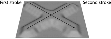

In this example, the two strokes both raise the surface to the maximum displacement distance, but not beyond it.

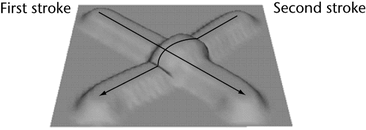

If you update the reference surface, the current state becomes the reference, and further sculpting will displace vertices from the new base point.
In this example, after the first stroke, the user updates the reference surface. The second stroke then applies the maximum displacement to it, going over the first stroke, which is now “baked onto” the reference surface.

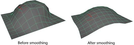

Smoothing
You can paint over bumps to smooth them out. This smoothing operation works by averaging the position of all features within the brush radius with all other nearby features.

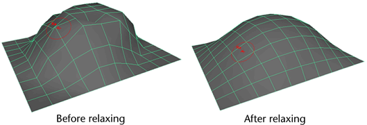

Relaxing
You can paint over bumps to relax the most out-of-place surface features. Unlike smoothing, Relax works by only averaging the largest surface anomalies so that the overall shape is maintained.

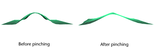

Pinching
You can pull vertices inwards towards the center of the tool cursor. Pinching is useful for making existing creases more sharply defined.
Note:
For more pronounced pinching, adjust the Brush strength slider in the Sculpt Geometry Tool options.

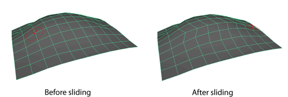

Sliding
You can slide the vertices in the direction of your stroke, while following the existing shape of the surface. It is recommended that you turn off Reference Surface: Update on each stroke when Slide is selected, because Slide uses the reference surface as the shape to follow.
Tip: When the Sculpt Geometry Tool is active, you can also access the Slide brush by Ctrl + Shift + right-clicking anywhere in your scene and selecting Slide from the marking menu.

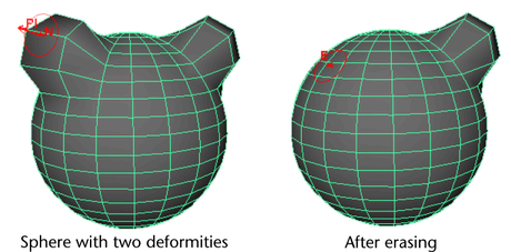

Erasing
You can save the state of a surface and then later erase changes to the surface back to the saved state.
You can also turn on an option to save erase state after every stroke, which allows you to erase only the last stroke you made.
