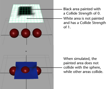

You can use the Collide Strength attribute to specify the amount of force generated when Nucleus objects collide with each other. Collide Strength lets you to control whether nCloth, nParticle, nHair and passive objects fully or partially collide with each other. At the default value of 1, the objects fully collide, values between 0 and 1 dampen the full collision. A Collide Strength value of 0 has the same effect as disabling the object's collisions.
Using the Paint nCloth Attributes Tool, you can paint Collide Strength values on nCloth and passive collision objects on a per-vertex basis. Painting Collide Strength values lets you disable or dampen the force of collisions for selected vertices without needing to create Disable Collision constraints.
Note:
When you paint areas of nCloth that you don't want to collide (Collide Strength: 0), select either the Solid brush, or the Square brush for painting. This ensures that the painted areas are totally black, meaning painted with a Collide Strength value of 0. Using the Gaussian brush or Soft brush does not paint the surface totally black. Areas that are not totally black have a Collide Strength value greater than 0 and will still collide.
