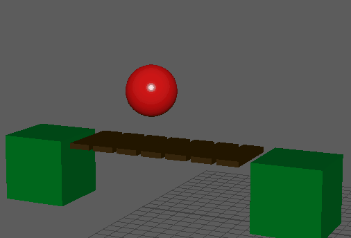

- Breakable
- Turn on
Breakable to make constraints that break apart when struck with enough input force. For example, in this animation, when the sphere drops, it does not have enough force to break the bridge constraint. But when the sphere is raised higher, enough force is created to destroy the bridge.
If you turn off Breakable attributes on the bridge hinges, the bridge will never break, no matter what forces are applied.
