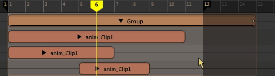

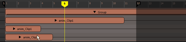

A white dot on a child clip indicates that it is trimmed because of the parent clip. The white dot does not appear if a child clip is too small to display.

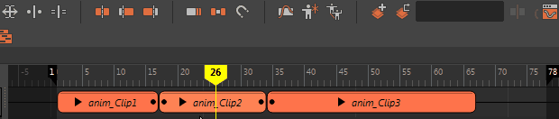

A black dot on the trimmed clip indicates that there is animation outside the clip.
See Time Editor Clip symbols for more. -
