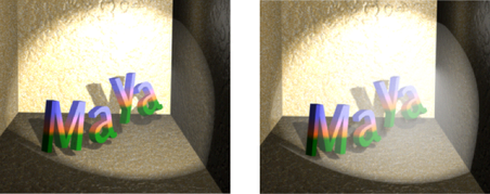

The following examples show a Light Fog applied to a Spot light using the default settings of 1.0, and the Fog Spread and Fog Intensity setting changed to 2.0.
Note:By default light fog is evaluated only at the boundary entry point. When the radius of the light fog is greater than the size of the volume fog, the amount of light illuminating the fog is the light intensity at the edge of the volume light (zero by default, but can be otherwise if the color ramp is edited). If you turn on Volume Samples Override on the Shape node (for example, sphereShapeNode) and increase the number of samples, the illumination of the volume light is better represented. Turning on Depth Jitter for the samples avoids stepping in these cases.

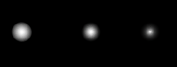

- Fog Radius
Only for point lights.
The Fog Radius value determines how much the fog spreads in every direction from a point light’s beam. The spot or point light’s Decay Rate controls how fog brightness decreases with distance from the light source.
The slider range for a point light is 0 to 10.The default value is 1.
