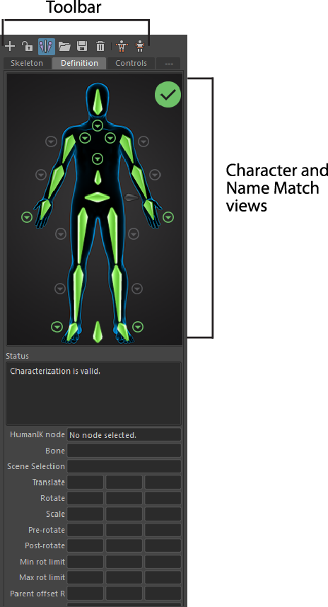

  • Open the HumanIK window (Skeleton > HumanIK) and select the Defintion tab at the top.
The Definition tab provides a visual interface for mapping the structure of your existing skeleton. This process results in a HumanIK skeleton definition that is required to create a Control rig and retarget animation to and from this character's skeleton.
This tab has the following main areas:

Create a new skeleton definition Click .
Map a bone Select one of the following methods:
  • Go from the Definition tab to your skeleton: Double-click a cell in the Character view (cells turn blue when picked), then click the corresponding bone in the scene. (You can also select bones in the Outliner or Hypergraph, for example.)
  • Go from your skeleton to the Definition tab: Select a bone then right-click the corresponding cell in the Character view and select Assign Selected Bone.
    Bones in the Character view turn green to indicate each valid bone assignment.
