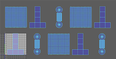

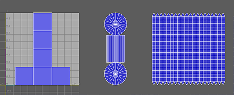

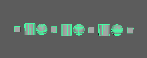

Determines the UV space for each mesh in the MASH network. For example, given the following MASH network
The available options would appear as follows:
Pass Through
UVs are placed in the same space as their source object, even if this means they overlap in 1,1 UV space.
By ID
The UVs corresponding to each object with a unique ID are placed side by side. UVs corresponding to objects with the same ID will overlap.
Unique
The UVs corresponding to every individual object are placed side by side.
