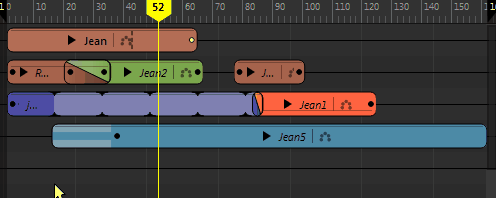

After you create a Animation Source, and bring it into the Time Editor, it becomes a clip on a track. A clip, which is the animation building block of the Time Editor, is an instance of the source. This lets you create unlimited clips from a single Animation Source. When you modify a clip, the Animation Source is not changed. However, if you modify the Animation Source, every clip that refers to it is affected.
Important: When an Animation Source is being reused elsewhere in the Time Editor, all instances of its title are italicized. This is to help you avoid modifying the clip if you modify an Animation Source clip in a composition. Be careful not to open the Graph Editor and move a key on the animation, or you will change the source animation.
To create a version of an Animation Source so you can make edits to, right-click the clip and Make Animation Source Unique from the Time Editor clip contextual menu. This lets you make the selected Animation Source independent from its originating clip.
Think of clips as containers that hold animation or audio on a track. You can have multiple clips on a track but they must be all the same track type, that is, animation or audio. See Time Editor Clip contextual menu for a list of operations you can perform when you right-click a clip in the Time View.
Tip: You can customize the default color of clips and tracks in the Color Settings Preferences. See Change user interface colors.
Note: The smallest size a Time Editor clip can be is 8 pixels. You can change the default clip size in the Minimum clip width field in the Animation (settings) Preferences.
Note: Special symbols appear at the trimmed or expanded edge of a clip to show the state of the animation contained inside. See Time Editor clip symbols for more

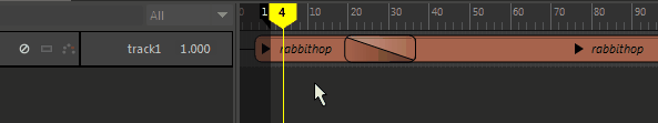

A Pose clip is a single-frame capture of an object or attribute state that you can use to create animation. You can blend Pose clips with transitions to create animation.
To create a Pose clip, click in the Time Editor toolbar.
See Create animation from Pose clips.

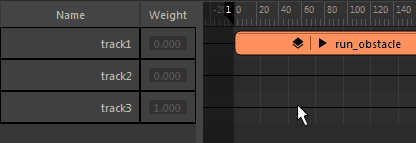

Clip Layers
You can create layers on Time Editor clips, so you can modify the existing clip animation. See Add Clip Layers to the Time Editor and Animate on layer clips. They behave similarly to Maya Animation Layers but are exclusive to Time Editor clips because you cannot drive Time Editor animation with both Animation Layers and Clip Layers as this creates conflicts.
Layer clips have a Clip Layer icon next to the name. Click this to expand the Layer view.
You can create a Clip Layer the following ways:
  • Select the layer clip and click the Create Override Layer or Create Additive Layer icons in the Time Editor toolbar.
  • Right click a clip and select Create Override or Create Additive from the Clip Layer contextual menu.
  • Note: If a clip is created from a driven object, a layer clip with all the driven Attributes is created by default.
The "Create Layer Clip" dialog box appears, letting you name the layer clip and add the object's attributes to the layer. Use the options to import only attributes or animation of these attributes.
Tip:
To key on a Clip Layer, select the Layer so the Active Clip field in the Time Editor toolbar displays the correct layer, or right-click a layer clip and select Set Active Layer. See Key on Clip Layers. The active clip layer is outlined in red.
You can group-select multiple Clips/Group clips and/or the appropriate scene objects and create a Layer clip.
Drag a Clip Layer in the track view to rearrange them. Remember that reordering clips affects clip evaluation, which is also dependent on the blend mode and weighting. Right-click a layer to set blend modes and merge layers in the Clip Layer contextual menu. You can also edit a layer's attributes.
See Add Clip Layers to the Time Editor.
Note: Be careful to use only the attributes you want an Override layer to drive, otherwise objects on your rig may be unintentionally pinned. Whenever you select a part of a character rig to create an Override layer, you create new animation based on the current pose; any inadvertently-selected nodes included with the layer will appear pinned at the current frame. See Animate HumanIK characters in the Time Editor for more on Override and Additive layers on HIK rigs.
