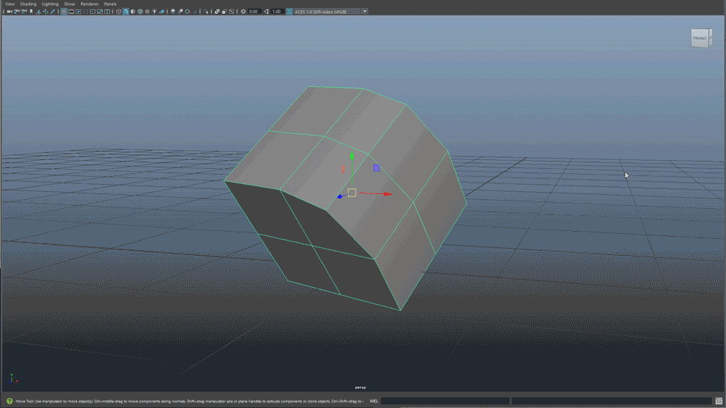

Smart Extrude is a powerful new extrude functionality for Maya, which lets you interactively extrude faces in the viewport and eliminates the need to manually repair double faces and unwelded results that occur during a traditional Extrude operation. With Smart Extrude, faces that are fully, partially cut-through or overlapped by the operation results are interactively rebuilt and stitched together, creating new manifold geometry, eliminating the need to manually repair hidden faces or geometric data. Therefore, you can freely explore and modify polygonal mesh topology on your object.
To activate Smart Extrude, first make a component selection of faces in the viewport. Then, select Edit Mesh > Smart Extrude and use the manipulator to drag faces in the Viewport. Any overlapping faces are automatically stitched and rebuilt into the mesh for clean topology results.

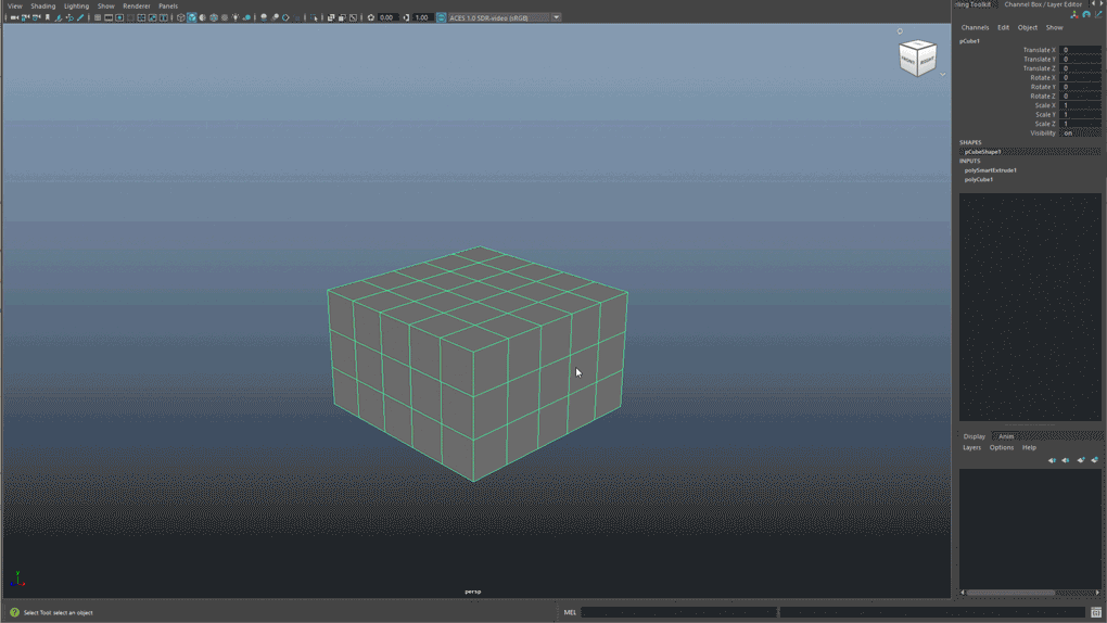

  5. Outward extrusions can be used to grow or join to other existing geometry, while inward extrusions are used to carve into the object.
  6. Inward traveling Smart Extrude can be applied across multiple edge segments, partially, or completely into/ through a mesh (including corners). In these cases, geometry will be deleted and removed where they intersect.

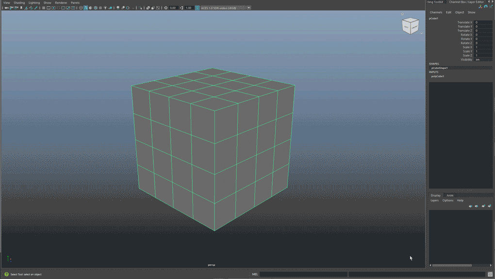

  8. An outward traveling Smart Extrude selection will join and stitch together with other polygonal data on the same Mesh object that it intersects with.

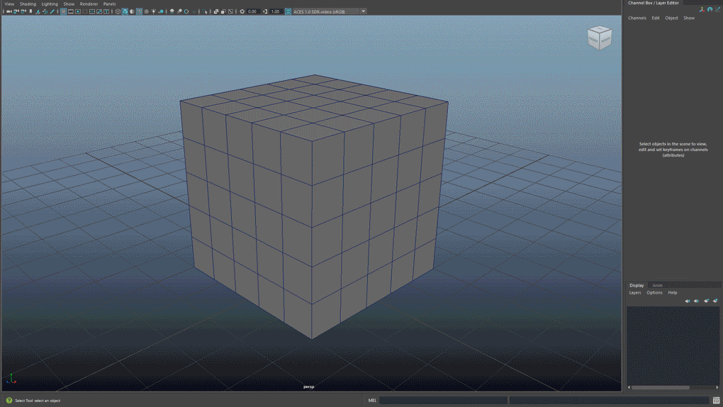

When extruding faces inward, Smart Extrude cuts through and deletes faces on any part of the mesh to allow the result to completely extend through. The resulting hole is restitched to the surrounding faces. This is similar to a Boolean Difference (A-B) operation. When extruding faces outward into another face on the mesh, any intersection is stitched together to produce a clean result. This is similar to a Boolean Union operation.
