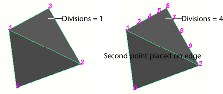

Divisions
Specifies the number of vertices to be added along the edges of the polygon being appended. The default is 1. Extra vertices are placed along the edges to create the subdivisions making the polygon multi-sided.
The following example shows the appended polygon subdivided with a setting of 4.
Note:
Setting the Divisions option is not the same as subdividing a polygons using Edit Mesh > Add Divisions. Divisions makes the polygon n-sided. Using the Add Divisions operation creates new faces by default. To create new vertices, you have to specifically subdivide the edges only (see Divide polygon edges for details).

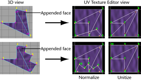

Texture space
Specifies how UV texture coordinates (UVs) are created for the appended polygon. Three settings are possible: None, Normalize, and Unitize.
Normalize
When Normalize is selected, the texture coordinates are scaled to fit into the 0 to 1 range of the UV texture space, maintaining the original shape of the UV face. For more information see Normalize UVs options.
Unitize
When Unitize is selected, the texture coordinates are placed on the corners and boundary of the 0 to 1 texture space. A polygon with three vertices will have a triangular UV texture map (with sides of equal length), while a polygon with more than three vertices will have a square UV texture map.
None
Specifies that UVs will not be created for the appended polygon.
