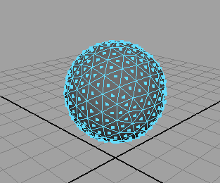

To model the balloon you will create a Icosahedron. This will result in more realistic movement than a polygon sphere.
  1. In the Polygons menu set select Create > Polygon Primitives > Platonic Solids > .
    The Polygon Platonic Solid Options window appears.
  2. Set Platonic Type to Icosahedron and click Create.
  3. Select Mesh > Smooth.
  4. In the Attribute Editor, select the polySmoothface1 tab.
  5. Set Method to Linear
  6. In the Linear Poly Smooth History section adjust the attributes as follows:
    • Division Levels: 1
    • Divisions per Face: 3
    • Push Strength: 0.8
    • Roundness: 2

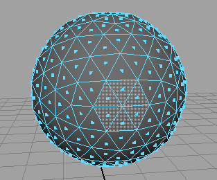

  5. On one side of the balloon, select 6 adjacent faces that form a hexagon.
  6. Press .
    The selected faces are deleted.

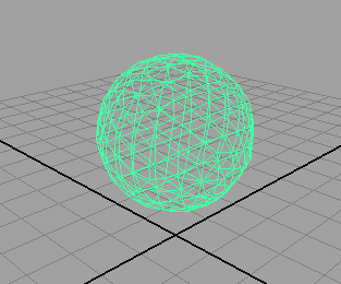

  1. In the FX menu set select the balloon and then select nCloth > Create nCloth.
    Maya converts the polygon balloon into an nCloth object.

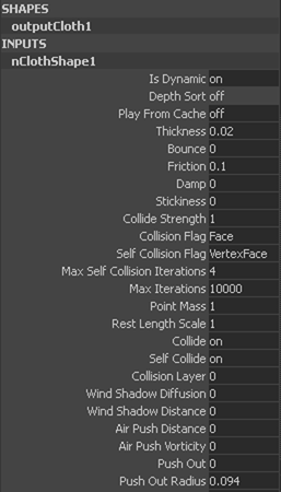

To adjust the balloon's attributes
  1. Select the balloon.
  2. In the Attribute Editor, select the nClothShape1 tab.
  3. In the Collisions section set Thickness to 0.02.
  4. In the Dynamic Properties section set Stretch Resistance to 80.
  5. In the Pressure section set Pressure to 0 and Seal Holes to On.
  6. In the Quality Settings section set Evaluation Order to Parallel.

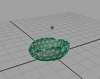

    The deflated balloon falls to the floor.

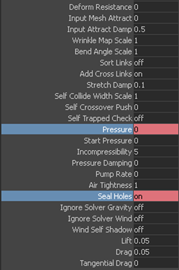

To inflate the balloon
  1. Go to the beginning of the playback range.
  2. Select the nCloth balloon.
  3. Open the Channel Box and under Inputs, select nClothShape1.
  4. Select Pressure and then -click Seal Holes to include it in the selection. -click either name and select Key Selected from the context-sensitive menu that appears.
    The fields will change color to confirm you set the keys correctly.
  5. Go to frame 200 of the simulation.
  6. Set Pressure to 10.
  7. Select Pressure.
  8. -click the name and select Key Selected from the context-sensitive menu that appears.

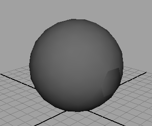

  9. Playback the animation.
    The balloon inflates very quickly initially, and then slows down until frame 200.
