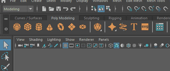

To use Blue Pencil to draw in the Viewport, do one of the following:
- Click the
Blue Pencil icon
in the
Panel toolbar.
- Select from the Animation menu set (F4).

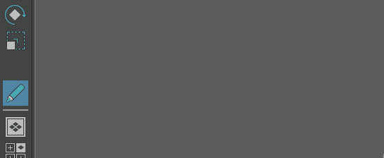

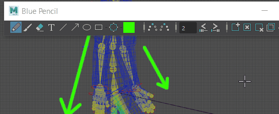

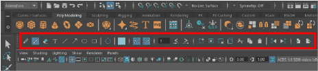

The Blue Pencil toolbar appears below the Shelf
| To... | Do this: |
| Open the Blue Pencil toolbar | Select the
Blue Pencil icon
from the
Panel toolbar. You can also select
| Close the Blue Pencil toolbar |
To close the Blue Pencil toolbar, click the X in the upper right corner. Note: Clicking the
X closes the toolbar, but
Blue Pencil remains active.
To exit Blue Pencil, press Q or switch to another tool. |

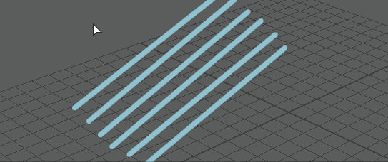

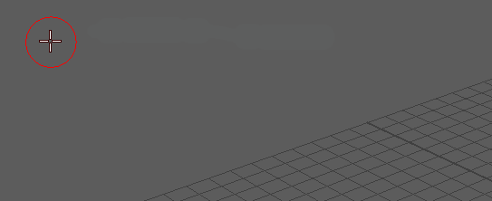

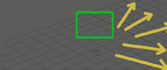

To change the stroke
size, press
B and drag in the Viewport.

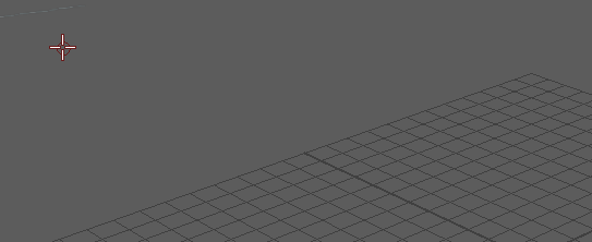

![]() To change
opacity, press
M and drag in the Viewport.

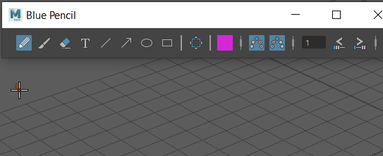

| Open the Blue Pencil Tool Settings | While
Blue Pencil is the active tool, double-click the
Blue Pencil icon in the Last Used Tool area of the
Tool Box.

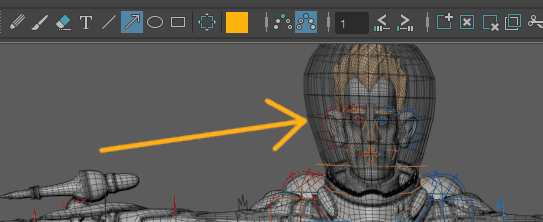

| Add a Blue Pencil frame for drawing |
Start drawing in the Viewport and a frame is created automatically. You can also click
Add Frame

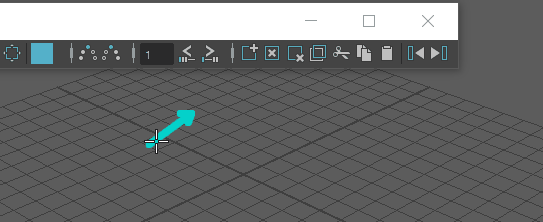

| Modify a drawing | Click the
Transform icon
and drag in the Viewport to select a region. (You can also right-click the drawing and select
Transform)
Once you have manipulated the selection, press
Enter (or right-click the selection and select
Apply Transform) to set it.

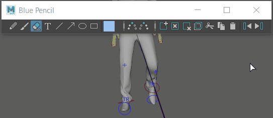

| Erase part of a drawing | Click the
Eraser icon
and drag the cursor across parts of the image you want to erase.

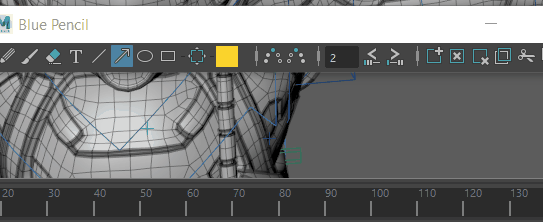

| Ghost frames | Click the
Ghost Previous
or
Ghost Next
icons to display
Blue Pencil frames that occur before and after.
Right-click the Ghost icons to set how many frames and what color is displayed.

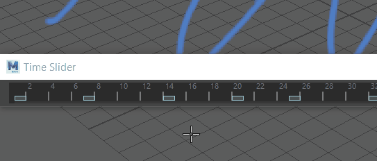

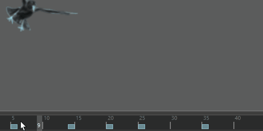

| Move Blue Pencil frames on the Time Slider. | Shift-click one or more frames on the
Time Slider and once highlighted, drag it to a new location.
You can Shift + drag multiple frames. ![]() To move one or more frames by a specific increment, see Retime Blue Pencil frames on the Time Slider below. |

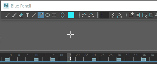

| Retime Blue Pencil frames on the Time Slider | Click
Retime Backward
or
Retime Forward
to move the frames after the current frame by the number of frames set in the
Frame Range field beside the Retime icons.

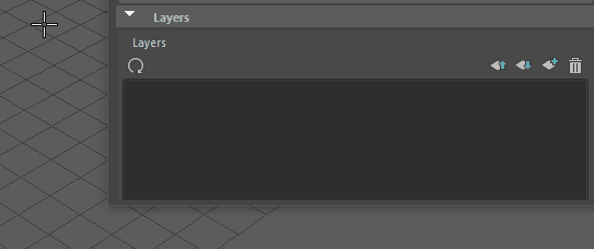

| Add a Blue Pencil layer to the Layer manager. | Draw in the scene and a layer is created for the current camera view. You can also click
Add New Layer icon
in the Layer Manager.
