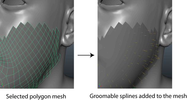

- Select the character mesh or faces of the mesh you want create hair or fur on.
- From the Modeling menu set, select .
- In the Create XGen Description window, type a New Description Name and Collection name.
XGen Descriptions store settings for positioning, generating, and controlling the splines. For more information about Descriptions, see XGen Descriptions.
A Collection provides a way of organizing Descriptions and the associated files your Description uses. For more about Collections, see XGen Collections.
- Set What kind of Primitives are made by this Description? to Groomable splines.
All other options in the Create XGen Description are automatically set.
- Click Create.
XGen creates a new Description and adds groomable splines to the selected surface.
