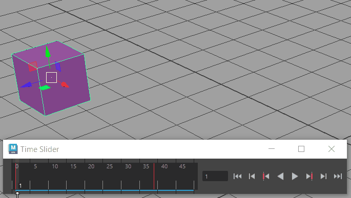

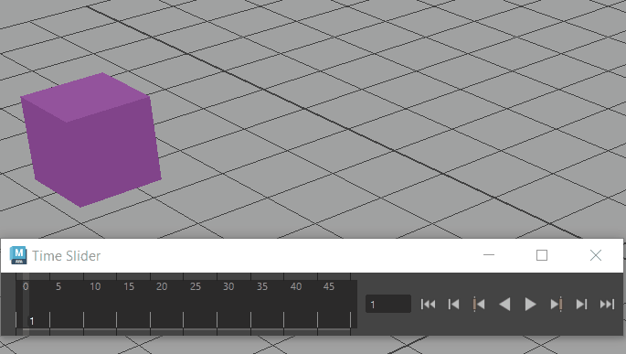

Setting keys on an object to animate it with the Time Slider
Keys are markers that specify the property values of an object at a particular time and space. Setting keys is the process of creating the markers that specify timing and action in your animation. Animation is the process of creating and editing the properties of objects that change over time.
Once you create an object you want to animate, you set keys that represent when the attributes of that object change during your animation.
To set a key, moving to the time on the Time Slider where you want to establish a value for an attribute, setting that value, then placing a key there (hotkey: s). Basically, you are taking a snapshot of the attribute at that time.
