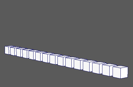

Allows you to inherit the animation of an object, then offset it in time.
MASH Delay
- Delay Mode
- Sets the delay method. Options include:
- Normal: Delays the effects of the connected nodes in the network per object instance.
- Follow the leader: Sets the object instances to follow a leader object on a delay.
- Time Step
- Controls the total time of the delay (in frames).
