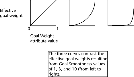

To tune goal weight animation
  1. Select the trailing particle object.
  2. Display the Attribute Editor and open the Goal Weights and Objects section.
  3. Set the Goal Smoothness to a value of 1 or greater, as follows:
    With a Goal Smoothness of 1, the goal weight effect increases proportionally as goal weight rises in small increments from 0 to 1. For higher values of Goal Smoothness, the goal weight effect increases slowly as values rise above 0, and quickly as the values approach 1. Objects have a default Goal Smoothness of 3.
