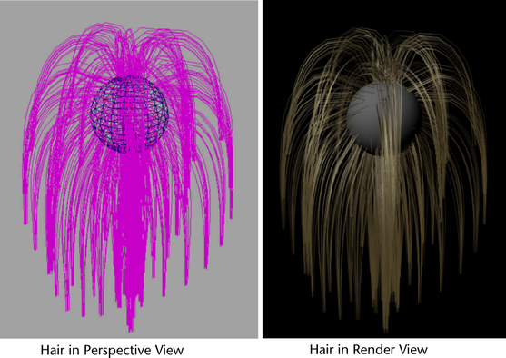

An initial workflow could be:
- Create a sphere and convert it to a passive collision object ( ).
- Create nHair. Hair sticks out normal to the surface.
- Play the simulation. The hair falls due to Nucleus dynamic forces.
- Once the hair is relaxed, select the hair curves and set the Start Position from the Current Position. ( .
- Animate the sphere as required to see natural motion or move the sphere during interactive playback ( ) .
- Render the scene.
