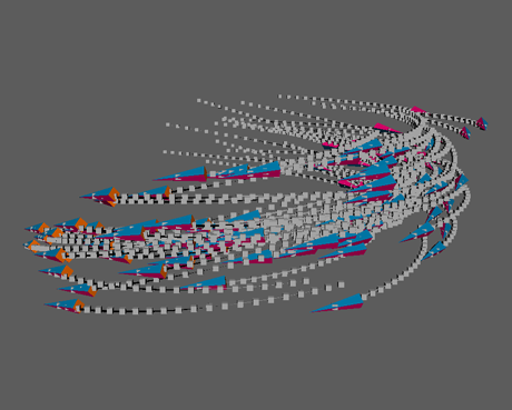

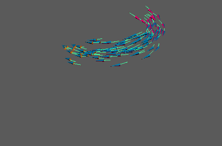

- Output Trail Points
- Creates a MASH point at each trail point when
Trails Mode is set to
Trails.
- Output Points to Nodes
- Determines the MASH networks to use when Output Trail Points is enabled. If multiple MASH networks are connected, the trails are assigned by point ID.
