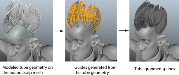

Use tube-shaped polygon meshes to define the shape of a default spline hair groom. XGen generates guides from the shape of the modeled tube objects.
You can then preview the default splines for the groom and then hide the tube objects. To use polygon tube objects, ensure they are open at both ends and have no interior boundary edges.
To style hair using Tube Groom

- Position the tube geometry on or near the surface of the bound mesh.
Ensure there are no gaps between the tube geometry and the surface of the bound mesh. The edges of the tube geometry can intersect the bound mesh, but they should not interpenetrate below its surface. Also make sure that none of the tubes overlap. This causes issues with the region map that the tube groom generates.

- Click
Generate.
The guides generated by the tube geometry display in the scene. Preview the Description to see the splines.
XGen also creates a region map based on the footprint of the tubes (guides generated from the tubes).
