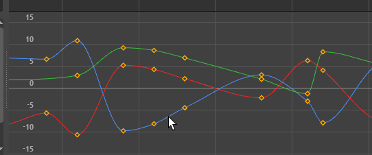

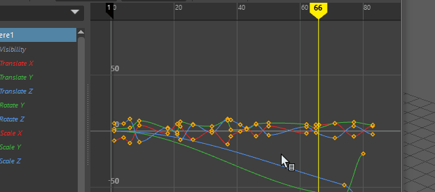

A graphical representation of interpolation between animation keys that you can modify.

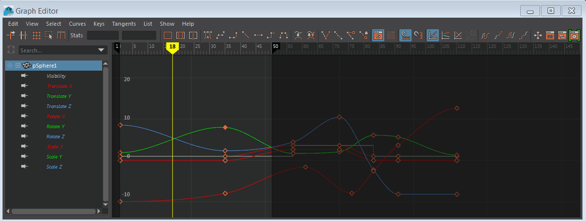

To open the Graph Editor:
- From the main menu bar, select .
- From the view menu bar, select > Graph Editor.
To view animation in the Graph Editor
Select an animated object, for example, a model. Any interpolation between two keys is represented in the Graph Editor as animation curves. See Set keys and Keyframe animation and the Graph Editor.
- The Move Tool is no longer needed to move keys
- Tangents are non-weighted by default
- Interactive keyframes and the ability to isolate curves
- Scrubbable Time Marker that moves anywhere you click on the Time ruler
- Resizeable play range
- Simplified view names. (Stacked Curves is now Stacked View, Display Normalized is now Normalized View and now there is an Absolute View.)
- Customizable key and curve colors (See the Graph Editor section in the Color Settings)

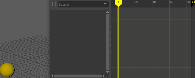

Place the Graph Editor in a scene view |
Select the scene view in which you want the Graph Editor to appear, then select . |

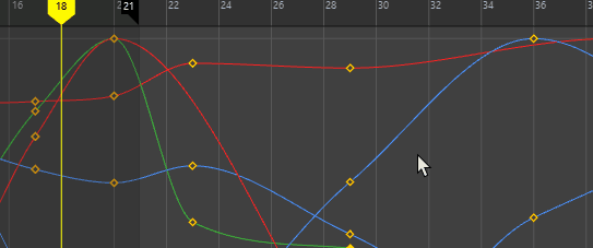

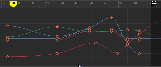

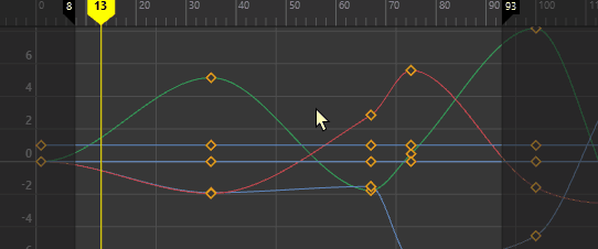

| Resize the Playback range | On the Time Ruler, click the edge of the dark region and drag to change the playback range. Stretch the playback range in the time view by dragging the flags on the Time ruler.
| Scrub animation | Drag the Current Time Marker.

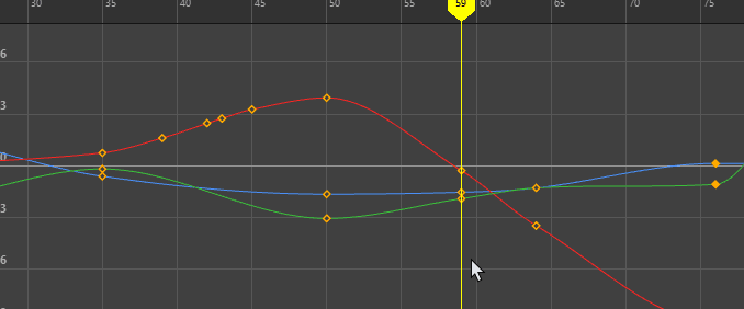

| Select and move groups of keys. | Drag a rectangular selection box, then hold
Alt and reposition the selection box.
![]() See also Region Keys tool. |

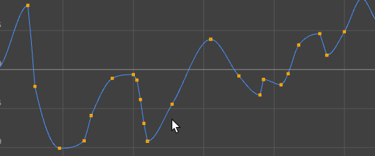

| Select a key on a densely animated curve | In the
Graph Editor
Select menu, activate
Prefer Selected Curves and click the curve with the key you want to edit.

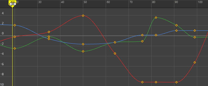

| Move a key | Select a key and drag it.
![]() To open the Move Key tool, select Settings. You can also middle-click an empty area of the Graph Editor and drag to reposition selected keys. ![]() |
| Nudge a key | Select a key and press
Shift +
9 or
Shift +
0 to move a key slightly to the right or the left by one frame.

| Move multiple keyframes in time without changing the attribute value | Drag-select the keyframes to move. Shift-middle-drag the frames left or right.
