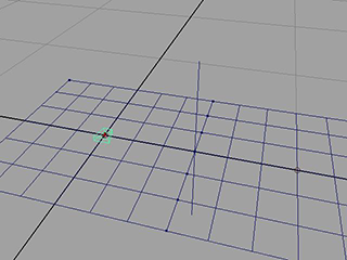

To make the planes nCloth

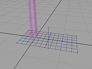

- Click the first plane and shift-click the other to select both.
- Select
Maya makes the planes nCloth.
- Playback the simulation.
The planes fall.

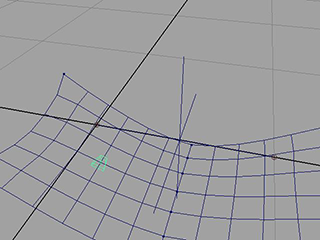

To prevent the cloth from uniformly falling, you need to constrain its corners.
To constrain the corners of the cloth
- Shift -select both nCloth planes.
- Right-click the nCloth and select
Vertex from the marking menu to switch to Vertex mode.
The planes’ vertices appear.

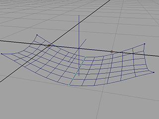

- Select the vertices on the outer corners of each plane for a total of four selected vertices.
- Select .
- Playback the nCloth simulation.
The pair of nCloths are now held in place by their corners. Both cloths fall at the point where they join.

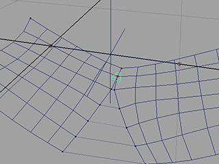

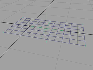

To join the two nCloths at their center
- Select both nCloths.
- Switch to
Vertex mode.
The nCloth vertices appear.
- Select all the vertices for both nCloths along their intersection.
Note:
Since the edges of both nCloths are on top of each other you may have difficulty choosing all the vertices on both planes. To make this process a bit easier, you can move the planes slightly apart from each other and then select the vertices. If you do this, make sure to return the planes to their original position before continuing with this example.
- Select .
The two nCloth objects are now joined at their center.

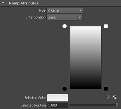

- In the right panel of the
Create Render Node window, click

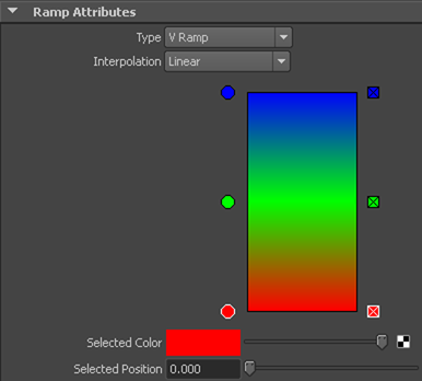

- In the
Ramp Attributes section of the
Attribute Editor click the box with an x at the center of the color ramp to delete the green marker.
- Select the small red circle at the bottom left of the color ramp. The colored box next to Selected Color should change.
- Click the colored box next to
Selected Color
The Color Chooser that appears.
- Select
black and move your mouse off the
Color Chooser to close it.
The bottom of the color ramp changes to black.
- In the Ramp Attributes section of the Attribute Editor select the small blue circle at the top left of the color ramp. The colored box next to Selected Color should change.
Selected Color
The Color Chooser appears.
- Select
white and move your mouse off the
The top of the color ramp changes to white.

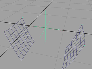

When you adjust the Selected Color slide bar during playback, the two planes zip and unzip.

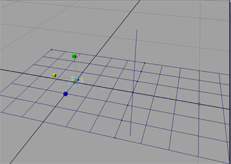

To create a controlling follicle
- Select the first plane.
- In the FX menu set select
- Select Edit > Reset Settings.
- Set the hair options as follows:
- U Count: 1
- V Count: 1
- Click
Create Hairs.
A single hair follicle with a number of hairs appears. For this example you will only make use of the follicle, not the actual hair.
- Open the Outliner.
- Select hairSystem1 and pfxHair1 and press the Delete key.
- Select hairSystem1Follicles and then pPlane1Follicle.
- Select curve1 and press the Delete key.
You now have a single follicle that you can use to control the zipper. You now need a model to represent the zipper.

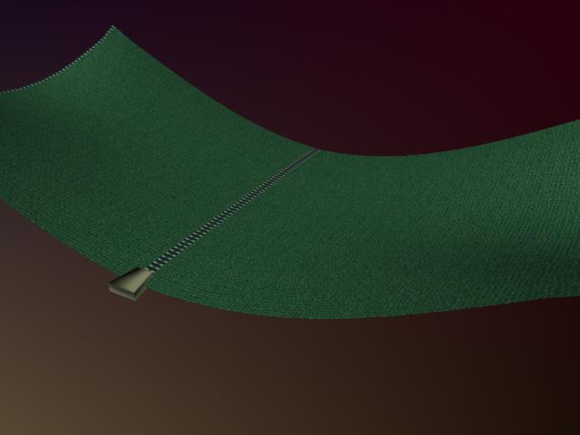

The zipper now sticks to the cloth.

Your zipper is now finished. To open and close the zipper you can now adjust the Parameter V attribute of the pPlane1Follicle5050.
