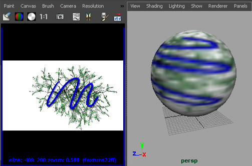

Although you can use the 3D Paint Tool to modify a texture by painting directly on the surfaces the texture is applied to, you can also modify the texture in the canvas and immediately see the effects on the surfaces.

  6. Change your layout to display both the canvas and a view of your scene (for example, Panels > Layouts > Two Panes Side By Side).
  7. In the scene view, turn on Hardware Texturing (Shading > Hardware Texturing).

  8. Paint on the canvas (see Paint on the canvas). The texture updates on the surfaces it is applied to each time you release the mouse button.
