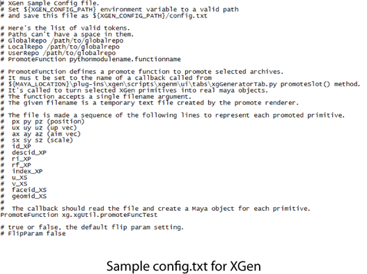

By default, XGen uses the XGEN_CONFIG_PATH environment variable for configuring file locations. It must point to a directory containing a config.txt properties file. The following image is an example config.txt:
