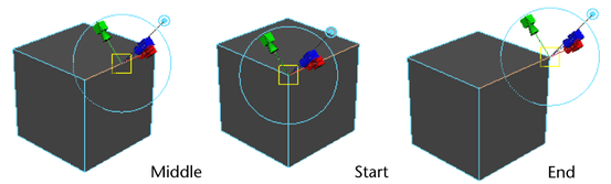

- Local center (edges)
Selecting an item from the Local center pull-down menu repositions the manipulator along the selected edge. Depending on which item you select, all subsequent transforms derive from that position. The default is middle.
