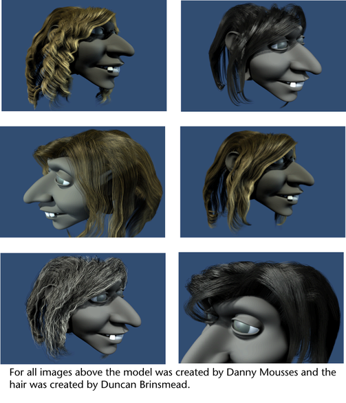

With nHair you can simulate:
- natural movement and collisions of long hair
- hair blowing in the wind or being blow dried
- hair when swimming underwater
- various hairstyles, including ponytails, braids, and updos
- collisions between hair and character clothing
- other dynamic curve effects such as ropes, chains, cables, wires, a suspension bridge, sea creatures, or even a lofted surface from a curve. For more information, see Creating other models and effects with hair.
