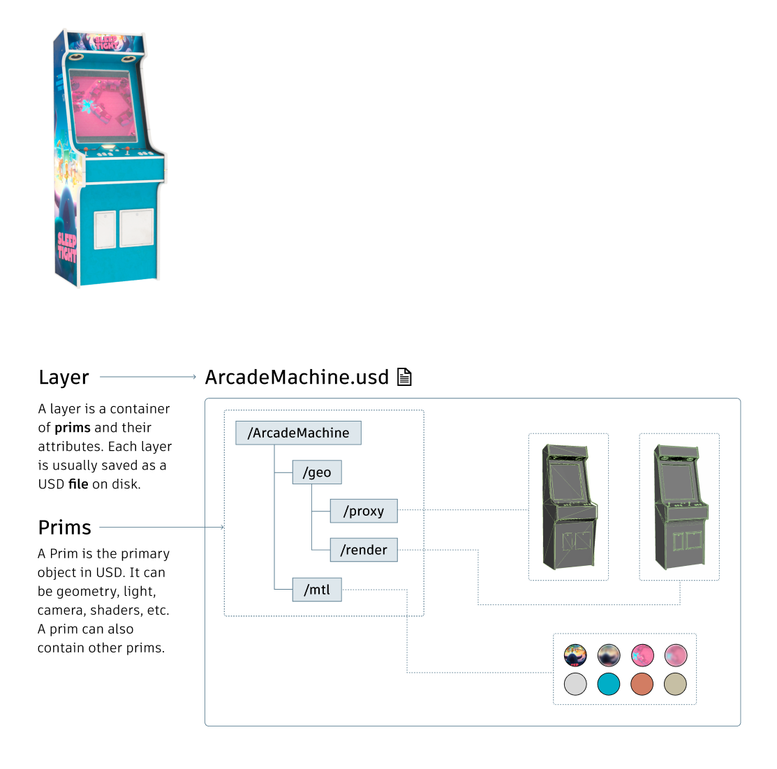

  • Stage – A loaded scenegraph, which can contain multiple Layers.
  • Prim (Primitive) – The primary object in USD. There are various types of prims, such as geometry, lights, cameras and shaders. A prim can also contain other prims.
  • Opinions – The basic elements involved in determining the values in USD. For example, when you author a value for an attribute of a prim, you are expressing an opinion for that prim.
  • Layer – A container of prims and opinions. Each layer is usually an indivisual usd/usda/usdc file on disk. Layers are composed together to represent a complete stage.
  • Composition – The process of assembling multiple layers together by the composition arcs that relate them to each other, resulting in a Stage scenegraph of Prims.

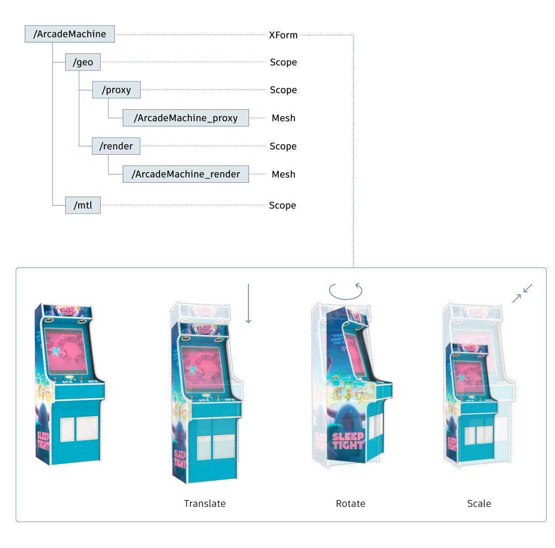

USD component
The following diagram shows an example of the structure of a USD component. The prim ArcadeMachine has two children, geo and mtl, which store the geometry and materials, respectively. The prim geo has two children, proxy and render, which store the low-res and high-res meshes for proxy and render purposes.
img for USD terminology & composition 1
Prim types
Prims come in a variety of types, such as XForm, scope, mesh, shader, light and camera. Among them, XForm contains transform data that can be used to translate, rotate and scale other prims; and scope serves as a container for grouping other prims without applying any transformation.

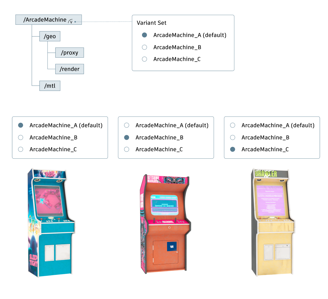

Variants
A prim can store multiple variants, allowing easy switching between them. Variants can be organized into variant sets.
img for USD terminology & composition 3

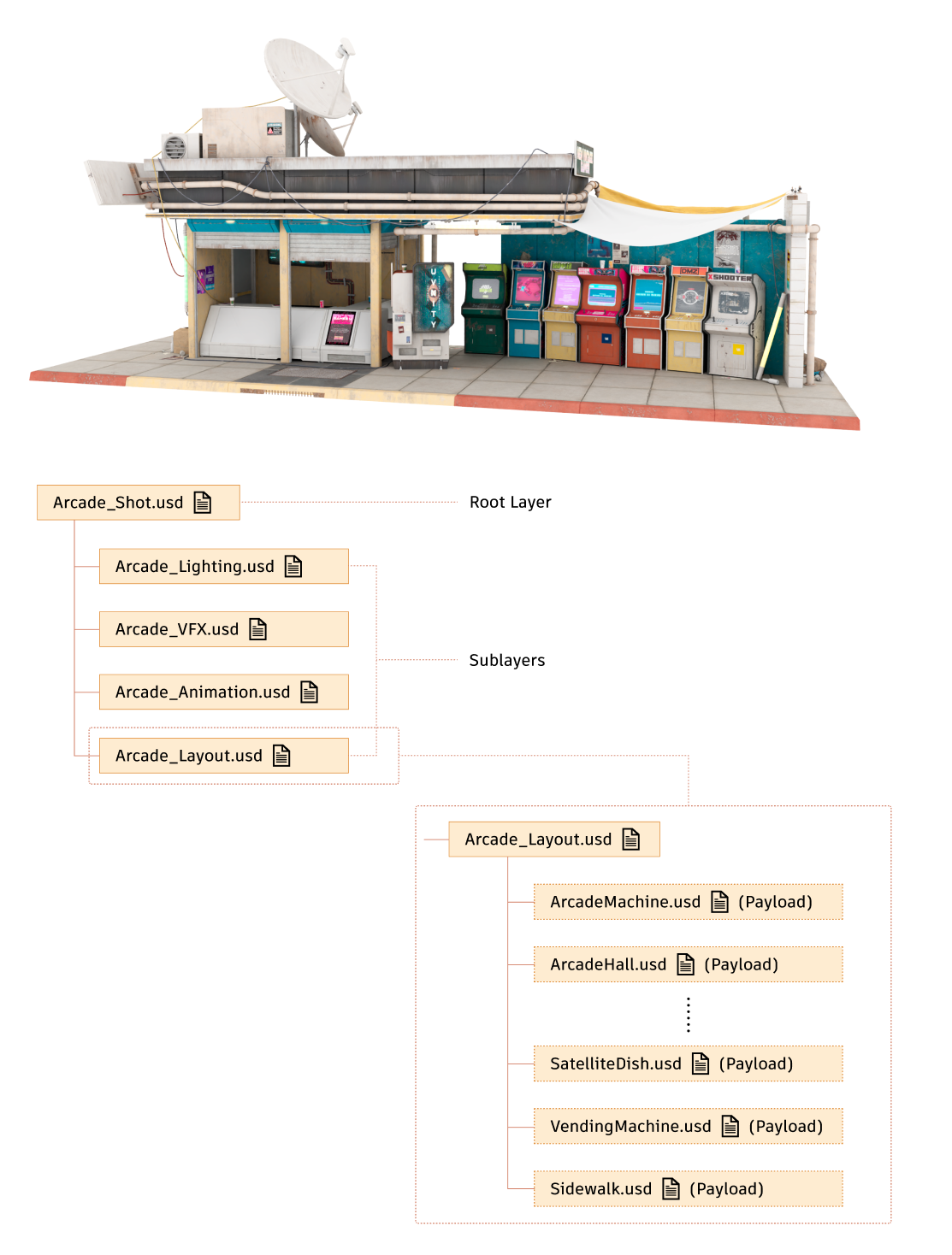

USD shot
A shot is usually composed of a root layer and several sublayers, each dedicated to a specific division of the pipeline, such as layout, animation, VFX, or lighting. Each sublayer references USD components as payloads. Instancing is often used when laying out a scene with multiple copies of an object. In the example below, only one arcade machine is loaded, while the others are instances of the same prim.
