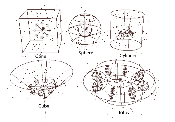

Emit nParticles from a volume shape
Volume emitters emit nParticles from a closed volume. You can choose from cube, sphere, cylinder, cone, and torus.
  1. Select nParticles > Create Emitter > .
  2. Under Basic Emitter Attributes, set the Emitter type to Volume.
  3. Under Volume Emitter Attributes, click Volume shape and select a shape from the menu.
  4. Set the Volume Emitter Attributes as desired and click Create.
    The implicit shape of the volume emitter is displayed on the screen. You can move, rotate, scale, or shear the emitter.
    Note: You can’t deform the volume or use an arbitrary volume.
To hide the shape of the volume emitter
  1. Select the emitter and selection Display > Hide > Hide Selection.
