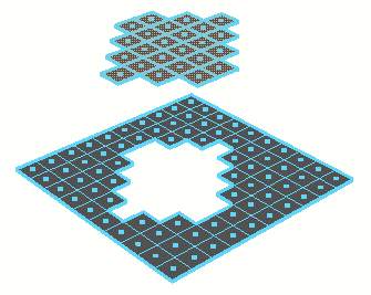

You can select and then disconnect faces from a polygon mesh using Edit Mesh > Extract. Extract removes the polygons by duplicating the appropriate edges and vertices based on the selection.
You can either place the extracted faces into a new shell within the same mesh object, or create a new polygon mesh using the extracted faces.

- If you want the extracted faces to become their own mesh, turn on Separate extracted faces. The extracted faces will be separated into their own separate object. Any pre-existing shells in the mesh will not be affected.
- Turn off Separate extracted faces to make the duplicated faces part of the existing mesh.

The Keep Faces Together option controls how Extract treats the edges of adjacent faces. When Keep Faces Together is on, the faces expand so their edges stay connected. When Keep Faces Together is off and Separate extracted faces is on, each face becomes a separate mesh.
