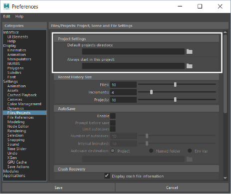

To select a different default location for your project
- Select Windows > Preferences from the Maya main menu.
- Select the
Files/Projects category and in the
Project Settings area, set a location as the default projects directory.
Next time you create a new project by selecting File > Project Window and clicking New, the project will be created in the location you specified.
You can also set a directory so that Maya starts with this project each time.
