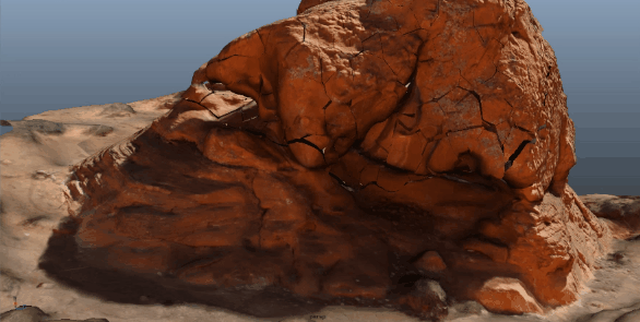

Avalanche effect using a Rigid Set containing 1000-fragment objects
