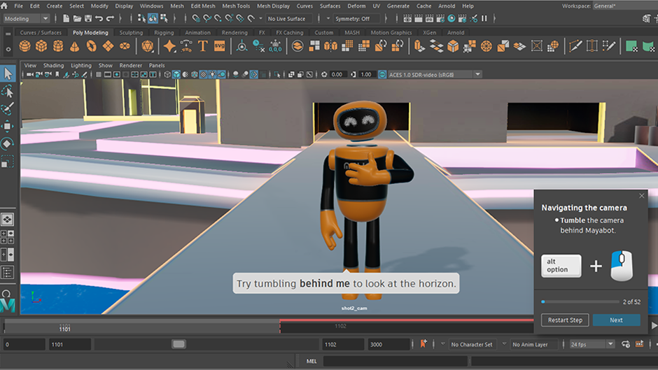

You can use the moverlay python module to display 2D overlays over top of Maya's UI. Situations where this might be useful include (but are not limited to):
  • Displaying instructions for an interactive tutorial
  • Pointing at UI elements
  • Displaying hotkeys for a custom tool
Overlays in Maya are built using Qt and support most HTML tags, including images, animated gifs, styles, and tables. To see a more in-depth, interactive example of what's available, run the following code in a Python Script Editor:
import moverlay
moverlay.mayaDemo.demoOverlays()
You can find moverlay in Python/Lib/site-packages in your install folder. You can also view the scripts included in the Interactive Tutorial Demo or Interactive Basics Tutorial to see more examples of 2D overlay code and usage.

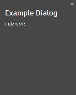

HIG Dialog:
A no button dialog window designed for displaying hints or diagrams
import moverlay as mo
from PySide6.QtCore import QPoint
def pressClosed(dialog):
    dialog.deleteLater()
#Create manager and dialog object
manager = mo.maya.overlayManager()
dialog = mo.higDialog.HIGDialog(manager.getMainWindow())
#Assign body text
label = dialog.setAsLabel('<h1>Example Dialog</h1><p>Hello World</p>')
#Assign close procedure
dialog.setCloseCallback(pressClosed)
#Re-size and position the dialog
dialog.theDialog().resize(mo.utils.DPIScale(180), mo.utils.DPIScale(250))
dialog.theDialog().moveToScreenPos(QPoint(0, 0))
dialog.theDialog().setFixedWidth(250)
dialog.showAndRaise()

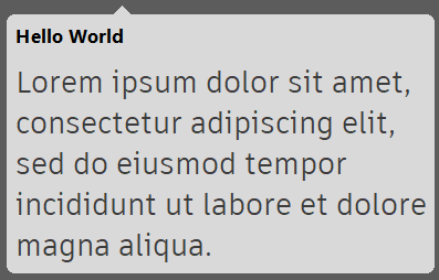

Bubble:
A non-interactable word bubble that appears in a designated position.
Note: To remove overlays, you can call overlayManager's deleteAll() procedure.
from PySide6.QtCore import QSize
from PySide6.QtGui import QColor
#Create manager and overlay definition
od = mo.overlayDef.OverlayDef(QSize(300, 100))
#Position relative to screen center and apply the style and color
od.style = mo.enums.OverlayStyle.SpeechBubble
od.attachment = mo.enums.RelTo.Center
od.bgColor = QColor(217, 217, 217, 255)
#Create this overlay
overlay = manager.createOverlay(od)
#Assign body text
label=overlay.setAsLabel("""<h2>Hello World</h2><p style="color: #3C3C3C; font-size: 16pt; font-weight: normal;
font-style: normal; font-family: Artifakt Element">Lorem ipsum dolor sit amet, consectetur adipiscing elit,
sed do eiusmod tempor incididunt ut labore et dolore magna aliqua.</p>""")
#Add a word bubble tail
overlay.addSpeechBubbleTail(mo.enums.Direction.Top, 0.25)
#Display the overlay bubble
manager.showAll()
