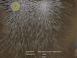

- Selection Mode
Lets you choose to apply the clumping effect to a selection of hairs or apply it as you drag across the hairs.
- Locked
- Click on the hairs to lock the brush's effect to hairs in the brush radius. Dragging any direction applies the clumping effect to the hair selection.
Selection Mode: Local

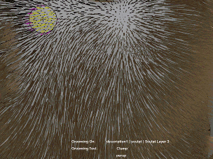

- Floating
- Applies the clumping effect to the hairs as you drag across them. This is the default setting.
Selection Mode: Floating
