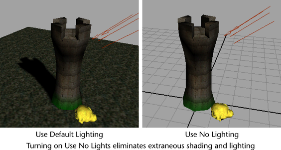

To avoid the interference of scene lighting with the display of vertex colors, turn on .
The following illustration shows the difference made on a tower that has prelighting applied and green color-per-vertex near the base. The rock in the foreground has no prelighting, so it loses all shading and highlights.
