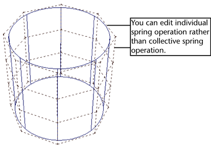

If you turn on Per-spring Stiffness, Per-spring Damping, or Per-spring Rest Length in the spring object, you can edit stiffness, damping, and rest length for individual springs.
Note:
You do not add per-spring attributes, like you add per-particle attributes to particles. Per-spring Stiffness, Per-spring Damping, or Per-spring Rest Length are built- in and those are the only ones you can edit.
