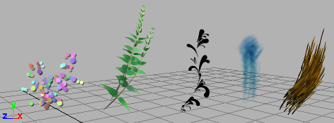

But painting traditional brush strokes in 3D only touches on the capabilities of Paint Effects. Painting Strokes with tubes opens up a whole new world of possibilities. As you paint a stroke, tubes sprout from the stroke path, like plants growing from seeds. You can define how the tubes sprout to achieve very complex results with a single brush stroke.
While the stroke itself lies on a plane or on a surface, tubes can sprout from the stroke path into 3D space. You can tumble and view the tubes from another angle because they are not simply textures on a 2D plane.

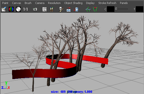

In the following example, the trees were painted with a single stroke with tubes, yet each tree is distinctly defined in 3D space. The ribbon is a surface woven between the trees. The 3D nature of Paint Effects strokes makes this possible.

You can also apply dynamic forces to the effects you paint in your scenes and animate the display and movement of the effects. For example, you can make plants grow, make long hair blow in the wind, or make a river flow.
