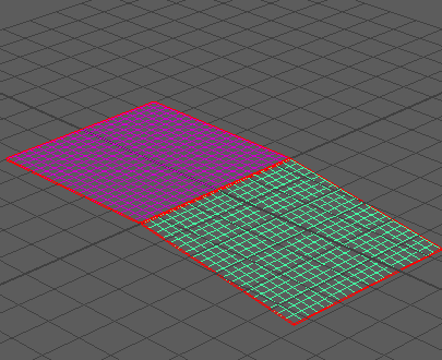

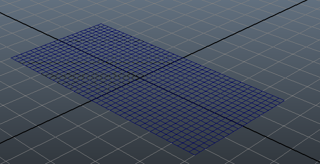

- Create two polygon meshes by selecting Create > Polygon Primitives > Plane. When you create each plane, set the Width and Height to 5.
- Translate the meshes so that they meet along the Z axis. One way to do this is to set the
Translate X value of one mesh to 2.5 and the
Translate X value of the other to -2.5.

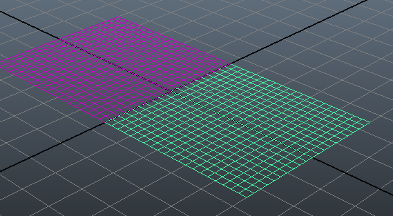

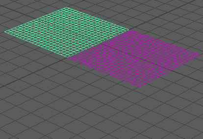

- Select one mesh and convert it to a passive rigid body by selecting Bullet > Create Passive Rigid Body. This is considered Rigid Body A.
- Select the other mesh and convert it to a active rigid body by selecting
Bullet >
Create Active Rigid Body. This is considered Rigid Body B.

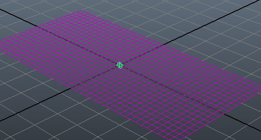

- Select two meshes and select
Bullet >
Create Rigid Body Constraint to create a constraint between them.
- In the Outliner (Window > Outliner), select the bulletRigidBodyConstraint node.
- In the Attribute Editor, click the bulletRigidBodyConstraintShape node tab.
- From the Constraint Type list, select Hinge. This creates a Hinge constraint between Rigid Body A and Rigid Body B along each object Z axis.
