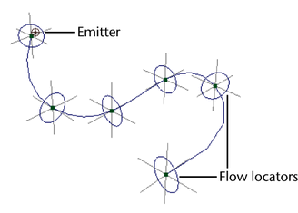

An emitter and flow locators appear on the curve. The flow locators are visual aids that show the maximum spread of the particles during animation. For details on altering the speed and spread of the particles, see Work with flow locators.

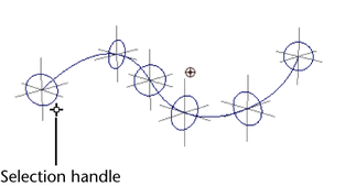

To display the attributes in the Attribute Editor, first select the Curve Flow node in the Outliner or workspace (see Curve Flow Group Name below). To select the Curve Flow node in the workspace, select the selection handle near the first flow locator.
If you use the Curve Flow effect two or more times on the same curve, you’ll see multiple selection handles near the first flow locator.

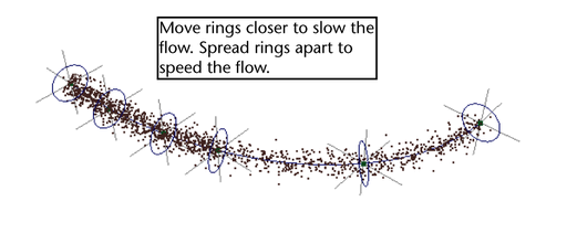

Flow locators control the speed and diameter of the flow in different parts of the curve. You can scale the flow locator rings to expand or shrink the flow diameter in that area. You can move the rings along the curve to speed or slow the flow in that area. This is useful when you’re simulating fluid flow down uneven surfaces. The flow is slower where rings are closer together. The flow is faster where rings are further apart. You can therefore space the rings to adjust the flow speed.

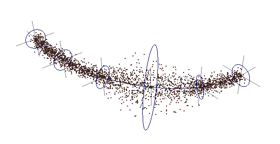

To expand or shrink flow diameter at part of a curve
- Select the Curve Flow node.

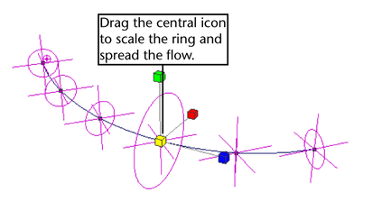

- Select the flow locator ring without selecting the curve.
- Select the Scale tool and drag the yellow scale icon to scale the ring along all three axes.
You cannot scale along a single axis. Emission always occurs in a circular region. The ring represents the outer boundary of emission at that point. Maya interpolates the emission diameter between neighboring rings. In other words, the emission diameter increases or decreases smoothly between neighboring rings of different diameters.
An example follows:
To speed or slow flow at an area of a curve
- In the Extra Attributes section of the Attribute Editor, edit the value of the desired locator. The locators are listed in the Attribute Editor in the order of their position on the curve. To move the locator, do one of the following:
- Try different numbers for a locator until you see it move to the desired position.
- Click the locator name in the Channel Box then slowly middle-drag the mouse back and forth in the workspace until you see the locator move to the desired position.

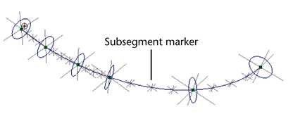

To enhance icon display
- In the Extra Attributes section of the Attribute Editor, set these attributes:
- Display Subsegments
When on, displays a marker at each control subsegment for better visual representation of their locations. You can’t change their location directly. You can do so indirectly by moving the flow locators.
- Display All Circles
Displays circles for the control subsegments. This simply makes it easier to see the subsegments.
