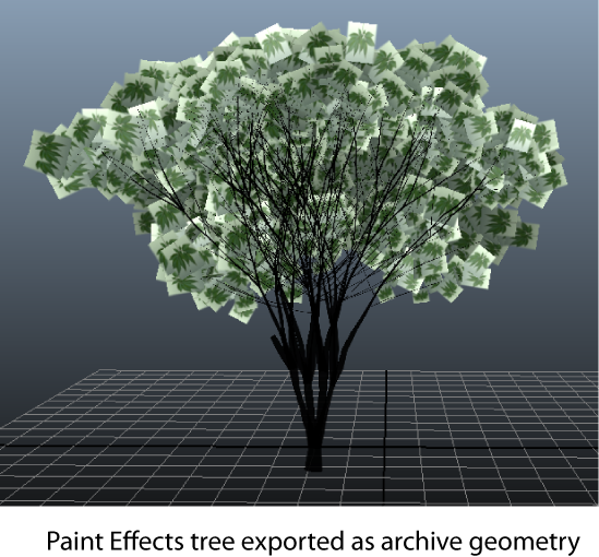

Before exporting the Paint Effects tree as an archive object, you must convert it to geometry (Modify > Convert > Paint Effects to Polygons).
  1. Select the geometry, and from the Modeling toolset, select Generate > Export Selection as Archive(s).
  2. In the Export Selection as Archive(s) window, set the following:
    • Destination Folder to User Archives ($){HOME}/xgen/archives).
      Maya saves the archive files to the xgen folder located in your user directory. For example:
      C:\Users\username\Documents\xgen\archives
      If you copied the default archive to this folder as described at the start of this workflow example, all your archive will be in the same location.
    • Type an Archive Name for the files such as PE_Tree.
      Maya uses this name for all the files generated for the archive.
    • Level of Detail to Disabled.
    • Click Export.
    Maya generates the custom archive files for the Paint Effects tree.
