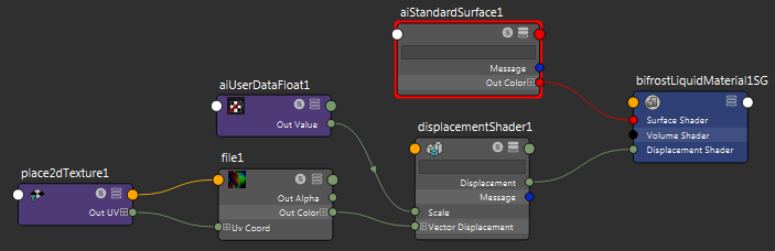

To blend with a flat mesh using displacement:
  1. Specify the flat plane for which the displacement map was created as the Mesh Plane.
  2. Specify the name of the Output Channel to use for blending. The default is ocean.
  3. Add the same channel name to the Export Channels list.
  4. In the Hypershade window, add a displacement shader to the liquid material. For more information about working in the Hypershade window in general, see Hypershade window.
  5. Connect a File texture node to the displacement shader's Vector Displacement attribute.
  6. Specify the displacement map in the File node's Image Name attribute.
  7. Use a utility shader to get the Output Channel you specified (for example, ocean) and connect it to the displacement shader's Scale attribute. The name of the shader and the procedure for this step depend on your renderer.
  8. Adjust the Boundary Radius and Offsets to control the blend.
