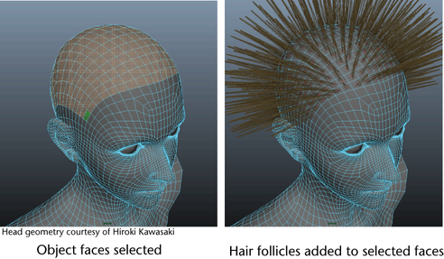

Creating nHair on surface components
Using the At selected surface points/faces option in the Create Hair Options window, you can create an nHair system on selected polygon faces or NURBS surface points. This option lets you place hair follicles on selected faces only. To adjust the placement of follicles after creating the hair system, use nHair > Randomize Follicles to add randomization values to the follicle locations. See Create nHair on components.
