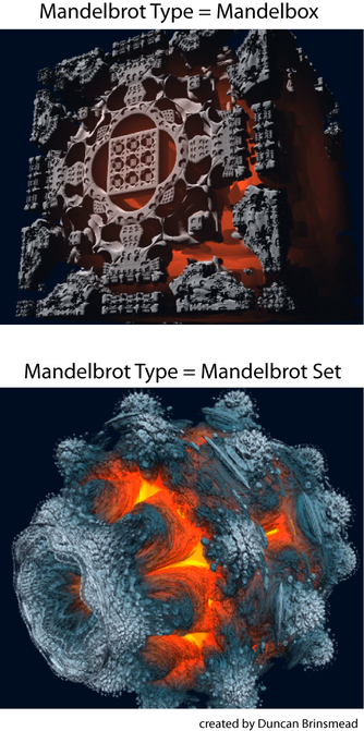

You can texture a fluid using the built-in Mandelbrot texture. The Mandelbrot set is a collection of mathematical points in the complex plane and the boundary of which produces an interesting fractal shape. Using this texture type, you can texture your fluid opacity with the Mandelbrot set as well as its different variations such as the Julia set, the Mandelbox set and other hybrid evaluations.

  5. Select among five evaluation types for the Mandelbrot Type: Mandelbrot Set, Julia Set, Mandelbox, Box with Julia Set, Box with Mandelbrot Set.

  12. Under Textures, increase the number of Lobes to, for example, 7.
    This is now a Mandelbulb.
  13. Under Textures, select Shaded Inside as the Mandelbrot Inside Method to make the surface more fine.
