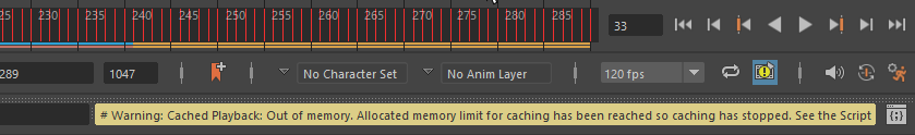

Caching and Memory
Caching will stop if your system does not have enough memory (RAM) to support the process. If a memory shortage occurs, a warning message appears in the Help line. Change the amount of memory Maya assigns for Cached Playback or if you want caching to continue despite memory limits in the Cached Playback Preferences.
Cached Playback out of memory state
Note: You can continue to work even if Cached Playback stops. You just won't have any playback performance gains.
