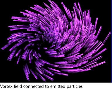

Fields are forces that you use to animate the motion of dynamic objects such as Fluids, Soft Bodies, nParticles, and nCloth. For example, you can connect a vortex field to emitted nParticles to create swirling motion.

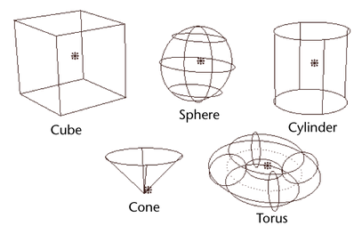

Volume fields
You can select a volume to define the region in space in which particles or rigid bodies are affected by any field in Maya. The volume shapes you can use are cube, sphere, cylinder, cone, and torus.
For example, if you create a Turbulence field and set its volume shape to cube, only particles or rigid bodies within the region of the cube are affected by the turbulence. Volume fields work with all fields in Maya, including volume axis fields. See Work with volume axis fields.
