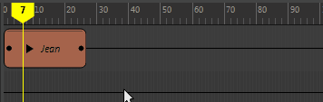

Scale
Lets you speed up or slow down the clip's animation. Select Scale from the Edit Mode menu, and place your cursor to the left or right edge of a clip. Notice the change in cursor look. Drag the cursor to scale.
The scale percentage appears at the top of the clip.
Tip: You can also press R with a clip selected to activate Scale mode.
Note: Special symbols appear at the trimmed or expanded edge of a clip to show the state of the animation contained inside. See Time Editor clip symbols for more

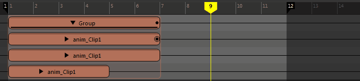

Trim
Lets you set the in and out points of a clip so that only part of the original source contributes to the clip. Select Trim from the Edit Mode menu, and place your cursor at the left or right edge of a clip. Notice the change in cursor look. Drag the cursor to trim.
A negative number on top of the clip indicates the number of frames trimmed.
A white dot on a child clip indicates that it is trimmed because of the parent clip. The white dot does not appear if a child clip is too small to display.
A black dot on the trimmed clip indicates that there is animation outside the clip.
See Time Editor Clip symbols for more.

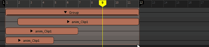

Extend parent clips
Resizes a Group clip to include the full length of a clip contained within it. When you edit a clip (moving, trimming, or scaling) inside a Group clip, you cannot extend it beyond the border of the Group, its parent. This is because the child clip is always constrained by the parent.
Note: The Extend Parent option expands the Group clip to accommodate the selected clip's complete animation only.
To extend a parent clip
  • Right-click a clip inside a Group clip and select Extend Parent from the Time Editor Clip contextual menu
  • Drag the edge of the Group clip to manually extend its duration
Note: Extension of Group clips occur only if the border of a child clip is inside the range of the parent clip. If a child clip is already outside the range, then the group clip does not extend. See Edit clips inside a Group clip.
