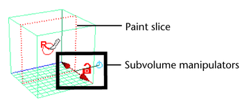

To paint in a 3D container you actually paint in two dimensions on “slices” of the container. A slice is a plane in X, Y, or Z that represents where you paint. (You could think of a slice as the canvas.) You paint each slice individually, but the accumulative effect of adjacent slices is a 3D fluid.
When you first select the Paint Fluids Tool, a paint slice displays at the origin of the fluid container. The slice is represented by a plane with dotted edges and fluid subvolume manipulators at one corner. When you move the pointer over the slice the pointer changes to a brush indicating that you can paint on the slice.
You control the location and thickness of the slices you paint using the fluid manipulators that appear at a corner of the slice. For details, see Display subvolumes of 3D containers.

- Move the paint slice to the slice you want to paint.
See Move the paint slice or subvolume.
