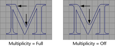

Multiplicity
By default, when you create a cubic curve, the end knots have a multiplicity factor of 3 and the arcs in between have a multiplicity factor of 1.
Full changes the multiplicity of the interior CVs from 1 to 3. To change a multiplicity factor from 1 to 3, there must be at least two CVs on each side of the CV being modified that have a multiplicity factor of 1.
Off changes the multiplicity of the interior CVs from 3 to 1.
