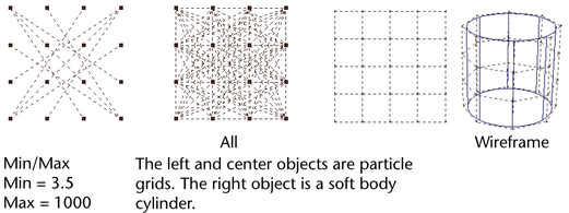

Creation Method
Set one of the following:
- MinMax
Creates springs only within the range of Min and Max Distance options. You can use the MinMax option to cause selected particles to adhere to each other, for example, to simulate a puddle of fluid.
- All
Creates springs between all pairs of selected points. Choose this option when you want an object to have a uniform spring structure throughout its shape, for example, a bouncing ball or block.
- Wireframe
Creates springs between all particles on the outer edges of a soft body. This option is useful for soft bodies made from curves, for example, a rope. It’s also useful for soft bodies with irregular surfaces, or for objects that you want to have a gel or liquid-like adhesion on its outer edges. See Wire Walk Length, below, for more details.

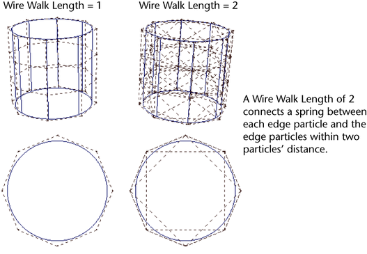

- Wire Walk Length
This option works with the Wireframe option. It sets how many springs are created between edge particles. For instance, for each edge particle, the value 2 creates springs to all edge particles within a distance of two particles. The higher the wire walk length, the stronger the structure of the soft body.
