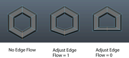

A polyEditEdgeFlow node is created whenever you perform and Edit Edge Flow command.
Poly Edit Edge Flow History
Edge Flow
Toggles edge flow on and off for the selected edges.
Adjust Edge Flow
Enter a value or adjust the slider to change the shape of the selected edges. This option lets you tweak your edge flow results.
By default, Adjust Edge Flow is set to 1. At 0 the selected edges move to the middle of the other nearby edges, creating a flat surface.
